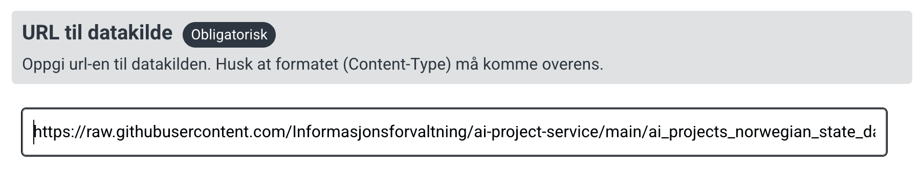

The URL to the data source should be the URL where you provide the data description from. In our case, it is the URL https://raw.githubusercontent.com/Informasjonsforvaltning/ai-project-service/main/ai_projects_norwegian_state_dataset_description.ttl.
URL to the data source is filled out with the link to the file on Github

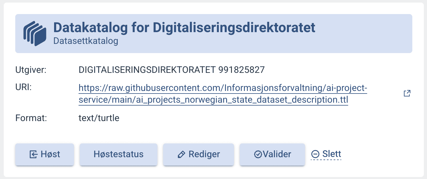

The data source should now appear in the list of data sources. Ours looks like this: The entry "Data Catalog for the Norwegian Digitalisation Agency" is displayed, with information about publisher, URI to the data source, format, and with the buttons Harvest, Harvest Status, Edit, Validate, and Delete
Note: You can validate the description by clicking "Validate." You will be taken to Data.norge.no's validation tool for descriptions.
Start harvesting
You can start a harvest by clicking "Harvest"; this will prompt Data.norge.no to retrieve and process the description before displaying it on Data.norge.no. This process may take a few minutes.
